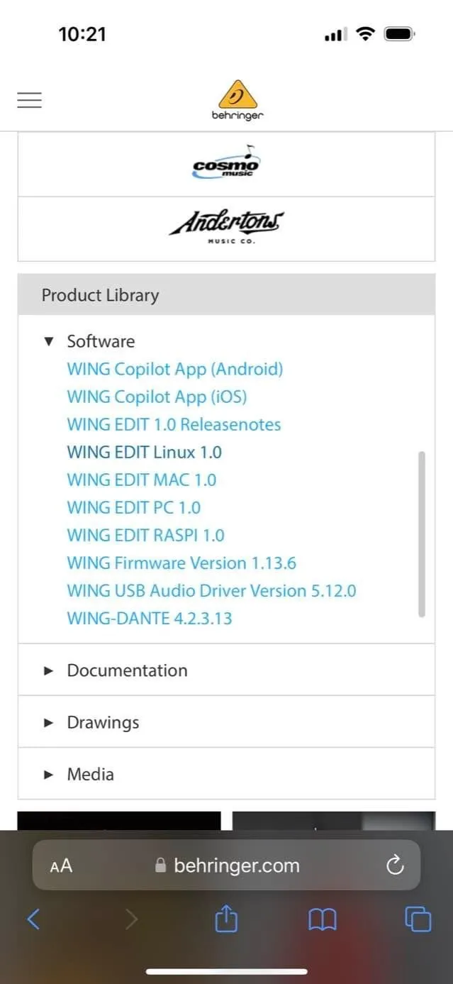

    So, es können alle aufhören zu jammern und raten, neue Firmware und Editor sind Online.
    Danke an Thomas Schröder für das Foto :)

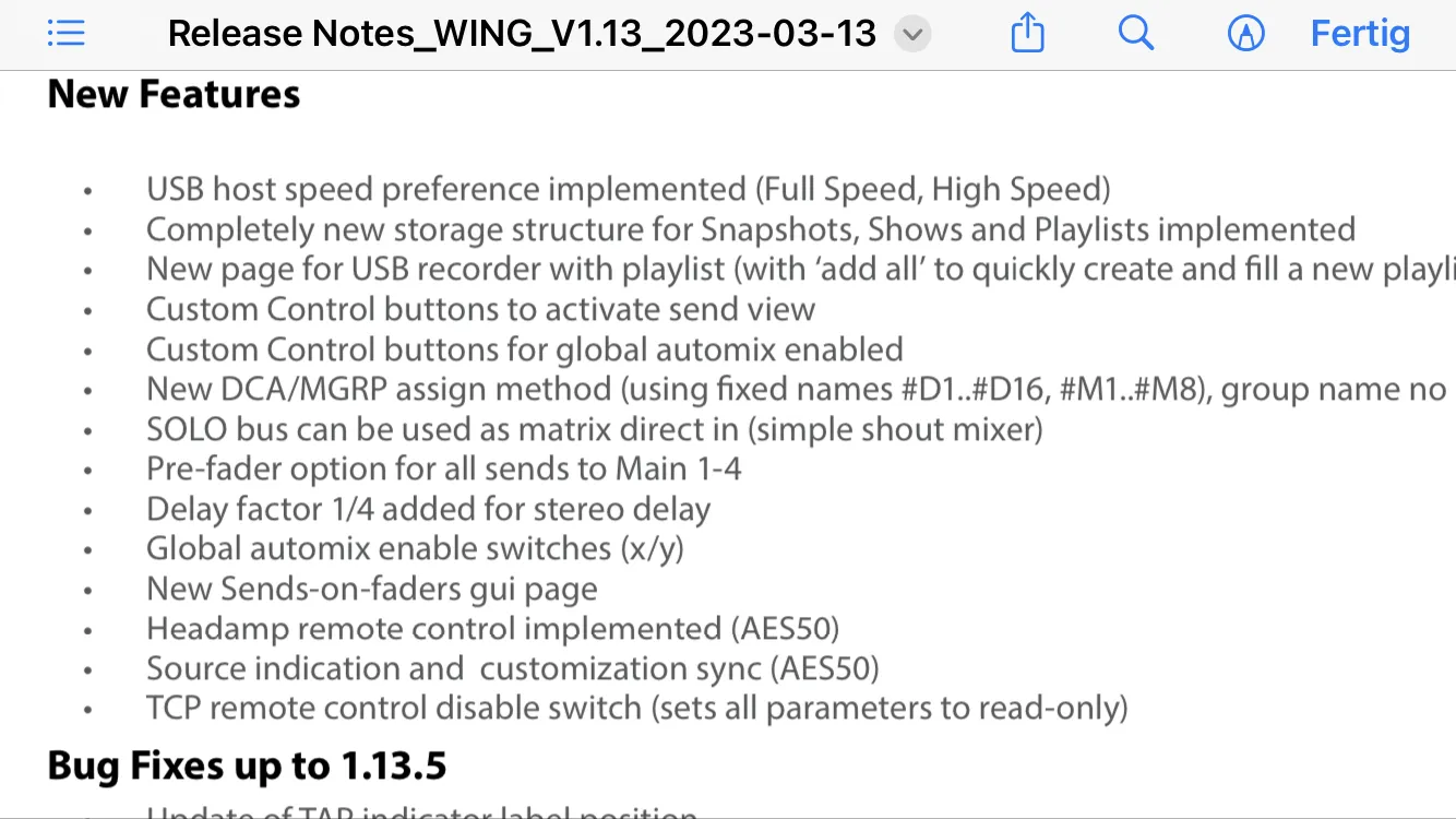

    Meine show am Samstag wird aufjedenfall noch auf der alten version laufen..
    NOTE: Fw 1.13 will require stagebox firmware updates for supporting HA remote control and the use of WING on both sides
    (AES50 A and B) of the stagebox. We plan releasing those updates in the next coming weeks, and suggest only using WING on
    stagebox A-ports until then. Using X/M32 series products on A- and B-ports is no issue, however
    Bissel scary.
    5.364
    15.055
    • 14. März 2023 um 11:39
    • #1.687
    ... und gleich mal noch zwei kleine Obachts!
    1.
    NOTE: WING EDIT currently can save and load console snapshots, but it cannot load old channel, FX and routing presets. This will
    be implemented with one of the next versions.
    2.
    NOTE: The fw 1.13 has changes on the remote control API and must be used with the recent app versions:
    WING CoPilot mobile app minimum version 1.12 and WING-EDIT application for PC/Mac/Linux 1.0.
    Previous CoPilot versions will not be fully compatible with WING fw 1.13 or higher.
    NOTE: Fw 1.13 currently cannot load old channel, FX and routing presets. This will be implemented again with the next versions.
    stagebox A-ports until then. Using X/M32 series products on A- and B-ports is no issue, however.
    Das mit den fehlenden preset libraries auch in der Pult-Firmware ist für mich ein echtes NoGo. Ich werde mit dem Updaten warten, bis ich meine preset libraries wieder laden kann.
